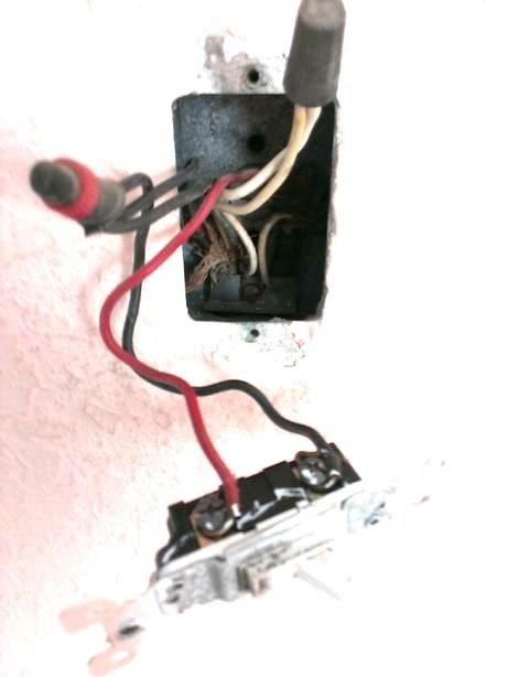

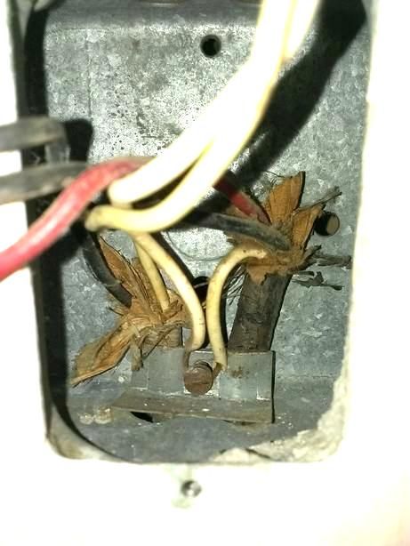

Just opened up the junction box behind a light switch, building was from 1960s, the work looks original.
Are these romex wires? They don't have a bare ground conductor and the jacket doesn't seem 100% plastic looks almost fiberous.
In any case I am concerned about the neutral conductor connected to the screw that clamps the cable to the box. At first I thought may be this is just someone using the white conductor as ground since being a switch there it is not necessary to have a neutral conductor present back then. But when I go to remove the light fixture and looked at the ceiling box, the white conductor is tied to a bunch of neutral conductors.
Should I leave it like this or is there a way to properly do this?
White is neutral and should never be used as a ground. People are under the impression that since it connects to the same point as the ground in the panel that it can be used as a ground. Not correct and very dangerous.
You need to make sure no neutrals are tied to the boxes.
That is old cloth covered two conductor NM cable. There is no ground which means you must use two prong receptacles.
