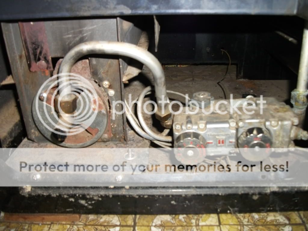

Hi All,
I'm trying to figure out how to get the heater portion of this gas range working It is a Kenmore, probably from the 1950's. Model number 103.657900. The range works quite well. The oven is functional, though it generally isn't ever used.
I can't quite figure out where the pilot light is on the heater portion. As you can see from the picture, there is a three way valve, with 'On', 'Off', and 'Pilot' settings. In the 'Pilot' position, the knob is meant to be depressed in order to light the pilot light.
I get no gas flow in the 'On' position. I'm guessing that either something is broken, or there is a safety valve cutting the gas since the pilot is out. Would the latter seem reasonable for a 1950's stove?
If so, can anyone tell me where the pilot light would be? Any suggestions on troubleshooting if it isn't just a matter of lighting the pilot?
Also, I tried finding info online, but all I could find is a poor quality parts diagram from sears, which didn't help.
Any suggestions would be appreciated.

Hello Mark. Welcome to Gas Appliances topic and our Do-It-Yourself Web Site.
First, locate the pilot assembly. Which is at the end of the smaller diameter aluminum tube leading out of the gas control valve. Assembly will be close to the burner under the burner cover.
Once you see the assembly, rotate the control knob located on the RIGHT side of the gas valve to the lowest temp setting number.
Then rotate the knob on the right side to the "PILOT" position. Light a match or use some thing like a match lighter hand held lighter and place the flame near the pilot assembly.
Once you accomplish that, depress the PILOT control knob into the fully depressed position. Pilot flame should appear. Once flame appears remove match and continue to hold pilot knob depressed for about one minute or so.
After the minute or so of time, slowly release depressed pressure on pilot knob and allow it to come out. Pilot flame should then remain ON.
Next is to move face and hands away from the area. Using one hand only in the area of the burner and control knob, rotate knob to the "ON" position.
Next is to rotate knob on left side to set temperature to one of the numbers from number one to what ever number allows burner to fire up.
The RED indicators determine which setting and/or function either control knob is set to.
Use extreme CAUTION lighting pilot and also when burner is turned ON. Flash back of flames is always possible. Which can cause serious burns and injuries!
Oh Yeah. You will not get any gas flow to burner unless the pilot will remain lighted after letting pilot valve up and control is in the ON position.
Nor will burner light if pilot will not light and stay lighted. Reason is the safety device inside the control does not allow burner gas flow if pilot isn't on or if it will not remain on.
Great pictures too! Helps us a lot when seeing the controls and trying to explain the lighting steps to be taken.....

Sharp Advice,
Thanks so much for the reply. I'll take a look at it this weekend and try to light it following the steps you outlined.
I do have two follow up questions though. I've attached another picture w/ a blue and red arrow for reference.
The blue arrow points to a little access door that can swing down horizontally and cover the opening. Is it through here that I would light the pilot? Also, is it safe to assume that this door should be closed prior to turning on the burner?
The red arrow points to an opening which can be made smaller (or closed completely) by rotating a metal plate clockwise. Should this be open or closed? Right now, it is open as far as possible. I'm guessing this is where the air is drawn for combustion, but I don't know much about gas stoves, and just want to make sure.

Hello: Mark
The RED arrow is the secondary air opening shutter which is used to change or adjust the volume of air to fuel ratio.
In almost all cases it will be fully opened as it presently is. I do not recommend the shutter position be changed from it's present position.
The BLUE arrow is where the pilot flame is lighted. Once you establish a constant burning pilot flame, yes, close that pilot lighting access door.

Hi Sharp,
Thanks for the reply.
The pilot won't burn at all. It's not a case of it becoming lit and going out. It seems that there is no gas flow to the pilot.
Any suggestions? What would cause this?
Thanks,
-Mark
Posted By: Sharp Advice Mark
If you got the pilot light to burn while holding the pilot knob depressed down, the flame should be all blue and impinging a safety element. If the pilot flame will remain lit after holding the pilot control knob down for at least 45 seconds to 60 seconds then releasing it, half the battle is won.
Once the pilot flame will remain lit and you rotate the pilot control knob to the on position, that knob on top of the gas control valve needs to be turned to the ON position. It controls gas flow to the main burner.
The control knob (marked warmer in red) with the numbers controls the room heat to temperature. That Honeywell control, with a control knob on top, differs slightly from the others used in wall heaters and/or floor heaters, etc.
The knob on top of the control may be there so the burner will not turn on even if the room temperature drops below the lowest set temp (#1) on the temp control knob.
If the pilot flame will not remain ON after lighting the pilot flame and holding depressed the pilot control knob, changes are the thermocouple (T-Couple) safety element is defective.
In this instance that part can be replaced separately. It is identical to the T-Couple used on gas water heaters and many other heating units. Can be obtained in any hardware store or BIG BOX store.
Defective T-Couple may be the cause for pilot flame not to remain on or the pilot flame is dirty with debris. In that case blowing out the debris may improve the pilot flames size and raise it's heat level enough to fully heat the T-Couple.
The T-Couples element will be in the pilot assembly next to the burner. From what I can see in the photos, the T-Couple looks to have an aluminum tube extending from it. Which indicates an original part.
New T-Couples are now made of copper or bronze or a similar type metal. You'll see them in the stores sold as replacement elements for water heaters.
Good Luck accessing the pilot assembly to remove and replace the T-Couple. Based upon viewing only the photos seen here, it can be a slightly difficult task. Also be carefully not to get scratched or cut on the hands nor arms during the process. That's all rusted metal that can be nasty and infection....

Hi: Mark
We are making progress here. Slowly but surely. I now have a better understanding of the situation too. There is no pilot flame because there is no gas to pilot assembly.
If the above is correct but there is gas to the burners, we can then assume one of four possibilities exists.
Air in the line(s) to the gas control valve to the heaters gas control valve and into the pilot assembly. The pilot gas will take a long time to arrive, meaning you will need to hold the pilot knob depressed for a longer time period for gas to arrive.
The gas control valves main burner shut off knob on top of the control, the knob with the arrow on it, is either closed indicated by the off position arrow. Or it needs to be in the on position to allow gas to flow to and through the valve. Be sure position is set to on position and retry pilot lighting.
2A
If that arrow knob needs to be in the on position to allow gas to flow through control before reaching pilot assembly, try lighting pilot with it in the on position and allow lots of time for gas to arrive at pilot assembly.
HINT: Watch the flame on the match. If air is there in the lines the flame on the match will indicate such. Flickering will be seen if flame is located in the correct pilot lighting position of the assembly.
If arrow has been on and there is gas to the appliance, burners work, then it is possible the pilot assembly is clogged with rust and or debris. Removal of pilot assembly will need to be done. Cleaning and clearing assembly and orifice is required.
3B
Pilot assembly removing & cleaning can be difficult due to the location of the assembly, age and condition of the parts and there tiny sizes. Orifice will be the tiny thimble like cup at the end of that tiny pilot gas supply tube. Hole in orifice extremely tiny.
Clean carefully, due not enlarge opening in orifice. When it's cleared light from a light bulb will be visible through hole. Which will not be a true hole but more like a rectangle. Clean and clear out air holes in assembly also and reassemble carefully.
Gas control defective. Internal failed and will not allow gas to pass through it for pilot nor burner. In this case a replacement would be the only solution. Gas valves are non repairable. Possible an original not to be found but a heating parts supply store may have a control that will work as a replacement.
Hope the above helps you further....
Kindly attempt the above, determine the findings and attempt the needed repairs. Then reply back with those final results.
