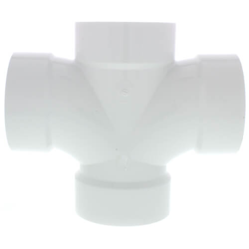

I am trying to move my washer into the utility room this weekend. I realize I have to have a separate trap and vent for each drain. Would the proper way to do this be to tie in at the point in the picture and then Tee off that into the vent pipe above?

You need to remove existing Y and add a combo fitting.
You cant stack Y's like you show.
A combo fitting is different from a double sanitary tee, so make sure you get the right one.
Double fixture fitting
Sanitary tee

Thanks lawrosa! So if I swap out the existing y with a Double fixture fitting then it will already be vented so no need to tie in the vent anywhere else correct?

Also, how do I tell the difference between a Double fixture fitting and a Sanitary Tee??? Home depot calls them "Double Fixture Sanitary Tee"!

Look at the differences in the posted Mike posted. There is more of a gradual sweep to the two side connections on a combo tee. Also your link is to ABS. You need PVC. If still not sure take the photo of a combo tee to a plumbing supply company.

Does that line go through the roof? If so that is your vent.
Notes: The washer standpipe is two inches and needs a P-trap.
Kitchen sink is 1½". Simplest to just buy a 2"x2'x2" combo fixture and reducer bushing for the kitchen sink line. They probably make a 1½x2x2 but it might be harder to find.

Whether or not you need an additional vent depends upon how far the trap is from the existing vent. There are rules for "developed length of trap arm" and they differ based upon the size of that trap arm, the horizontal piping from the trap outlet to the combination fitting or sanitary tee.
VERY generally speaking, if the trap arm is more than four feet then a re-vent IS necessary. Some jurisdictions will allow the use of an "air admittance valve" (AAV) and others absolutely will not allow them. An AAV must be installed above the "flood plane" of the fixture or as high as possible to prevent flooding in case of a clogged drain and AAV failure. They also must be installed in a permanently accessible area because they DO require maintenance and sometimes replacement.

Yes on the 2x2x2x2.
The probably do not make a 2x2x1 1/2 because the whole thing about the combo fitting is the weir. And 1 1/2 on one side would change that.
The real difference is that , the height of the left and right inlets are higher, in relation to the center vent stub.
And from your pic, yes no need to vent. The existing is the vent.

Ok got it! Yes, that pipe that the sink drains into does vent to the roof.
I have not run the pipe for the the washer drain yet so I will be sure that it is no more than 8ft. Went to home depot today and they did not have any Double fixture fitting. Looks like I may have to order it online.

Ughh, looking at the pictures I think they gave me the wrong thing. Why is this so complicated..The plumbing supply place should know what the right fitting for the job is

Just chiming in on the max trap arm lengths.
3" pipe is 6'
2" is 5'
1 1/2 is 42"
These are the lengths in my iapmo international code book and what is enforced in my state. If you can't find the fitting mentioned above there is another piping option that is a little more work but not difficult

Ok so I brought the other one back. I am just going to order it online as I went to 3 local plumbing supply places and they all wanted to sell me the sanitary T wye fitting.
Is this the one that I need https://www.amazon.com/gp/product/B0...KIKX0DER&psc=1 or is there a better place to buy them?
Also, I just called the local plumbing inspector and he stated max distance between trap and vent line for 2" is 6 feet and 1 1/2" is 5 feet :/
