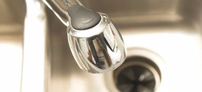

1. Low Water Pressure
A faucet aerator.
When your sink's water stream loses pressure, it can turn washing the dishes into even more of a pain—and a longer one at that! A clogged aerator is usually the culprit behind this crime. A buildup of dissolved minerals like calcium in the small openings of an aerator can be at the root of this problem. Households with hard water or water that is high in mineral count are particularly susceptible to low water pressure. To solve this, remove the aerator (it's the tip of the faucet) by taking pliers and gently unscrewing it from the rest of the faucet. (Wrap your pliers in duct tape prior to use to avoid scratching the fixture.) Then, take the piece apart, separating it by component. Place the pieces in a small container filled with white vinegar for six hours or more. Remove the piece, reassemble it, and then reinstall it onto your faucet. If the aerator was the reason behind the weak stream, this should solve the problem. If the problem persists, consider calling a plumber to ensure you don’t have a pressure issue or a clogged pipe.
