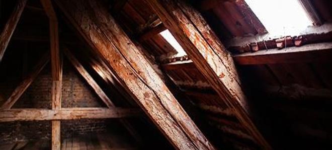

5 Steps to Installing an Attic Gable Fan
Installing an attic gable fan is something that any home improvement fan should be able to do in a matter of hours. It can help to improve the circulation of air in your attic for decades. Heat in your attic is one of the reasons why your home seems to hot in summer, and installing an attic fan can make an enormous difference in how you keep cool during the warmer months.
