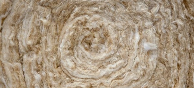

Fiberglass Batting for Insulating Tight Places
Exposed joists in basements need to be insulated. Use fiberglass insulation to fill these holes where the wall and the floor meet. Snugly place the fiberglass batting here, but not wrap it so tightly that it is compressed. Wear a face mask, gloves, and long-sleeved protective clothing when working with fiberglass.

  • Rolls, Batts and Blankets - A flexible insulation specifically useful for wall studs and floor and attic joists.
