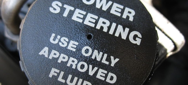

When your vehicle has power steering problems it can make driving the car much harder when it comes to steering and turning. The power steering unit of your car makes turning much easier through a hydraulic system. This system builds up pressure as you turn the steering wheel and pushes the wheels to either side as you turn the wheel. When there are power steering problems you will instantly notice the difference. There are a few common problems that are associated with the power steering. Here are a few to help you diagnose your vehicle.
Power Steering Leak
The most common power steering problem that people are going to find is a leak in the system. This problem has a few different signs that will help you diagnose is pretty quickly. Besides the tell-tale sign of fluid on the drivers side of the vehicle, you will also notice a grinding noise when you turn the wheel. When you hear the grinding noise you are getting to the point where the fluid is very low and it must be fixed quickly. If you run out of fluid, the pump can burn out completely.
