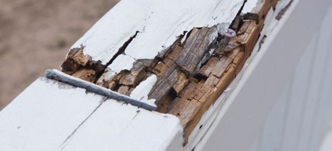

1. Rotting Siding and Trim
Rotting siding and trim will only get worse over time. Rot can spread to nearby areas, making a small project much bigger down the line. Rotting wood also invites pests, like carpenter ants, that will tunnel through perfectly dry wood and set up a nest in your home.
To replace rotting siding and trim you'll need to remove the rotting piece and replace it with new wood. Make sure that when you remove the rotting piece, you cut into dry wood. That way you'll be sure to eliminate further damage. If you aren't comfortable doing the work yourself, you can hire a general handyman or carpenter.
