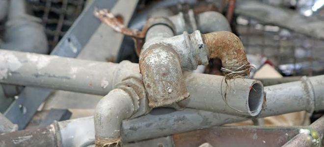

4. Old Pipes
Many older homes have galvanized pipes and they must be removed according to the building code in your area, especially when selling the home. Galvanized piping corrodes and rusts easily from the inside, causing low or uneven water pressure, discolored water, and potentially severe leaks. They are silver in color which distinguishes them from copper or plastic pipes which are up to code. If you are unsure, this trick may help you: a strong magnet will not stick to plastic or copper pipes, but it will stick to galvanized steel.
Less common, but still found in older homes, are lead pipes, especially where the main water line comes in. A good place to check is in the basement. These can be mistaken for galvanized pipes because they are gray, however, they will be less shiny and more matte. Furthermore, lead pipes will be softer (hence why lead can leach into the water supply) so if you scrape a small area with a screwdriver, the metal will move away easily. Also, a magnet will not stick to lead. Remember, a house can have different systems of pipes added over the years so if you are unsure, call a professional to assess if you have safe piping throughout the whole home.
