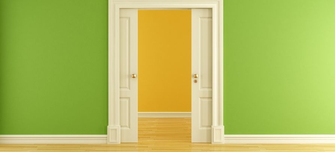

A pocket door is a special type of sliding door which disappears into a pocket in the wall. Fitting double pocket doors is a fantastic way to improve the look of your home, and it's a great space saving door design which opens without obstructing the passageway at all.
You will need to remove a section from your wall in order to allow the door to disappear in the pocket.
