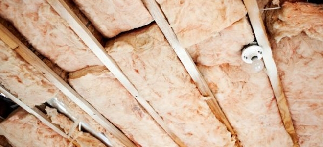

Install blanket or bat fiberglass insulation
- Installing fiberglass bats requires building a stud wall around the exterior of the basement and filling the gaps with fiberglass insulation.
- The openings in the stud wall or the air space behind it allows for the installation of wiring or plumbing for the new living space before adding the insulation. After the insulation is installed the wall can be covered with drywall.
- Because of it's adaptability and versatility this insulation method is commonly used when home owners are planning to develop their basement for additional living space.
- Similar to foam insulation, building codes require the fiberglass bats to be covered with a vapor barrier (often a 6 mil plastic sheet stapled to the studs with the seams overlapped then covered with moisture proof tape), before installing the drywall and closing in the wall.
