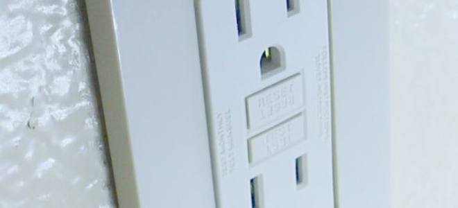

Are special outlets needed for bathroom vanity lighting fixtures?
by DoItYourself Staff
Special outlets are needed for bathroom vanity lighting, as well as near the tub or shower. Water and electricity are a lethal combination, and it is very important to install the correct outlets for safety. Any outlet installed within approximately 6 feet of a sink, tub or shower, will be required to have ground-fault circuit interrupters, or GFCI's for short. Check with your local codes office for the exact distance required, for your particular area. These outlets protect you from electric shock, in the event that water comes in contact with the outlet, or an appliance, such as a hair dryer or electric razor falls into water while in use.
