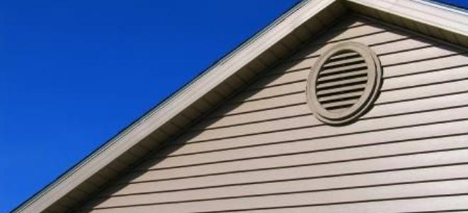

A Note about Attic Fans
Attic fans are inteneded to cool hot attics by drawing in cooler outside air from attic vents (soffit and gable) and pushing hot air out through the fan. However, if your attic is poorly ventilated and not well-sealed, attic fans can draw conditioned air up from below, making your air conditioner work harder and increasing your energy bill. You don't want your unfinished attic cooled by your air conditioner. To prevent this effect, follow the air sealing and insualation strategies and make sure the attic is well-ventilated using passive vents and natural air flow.
