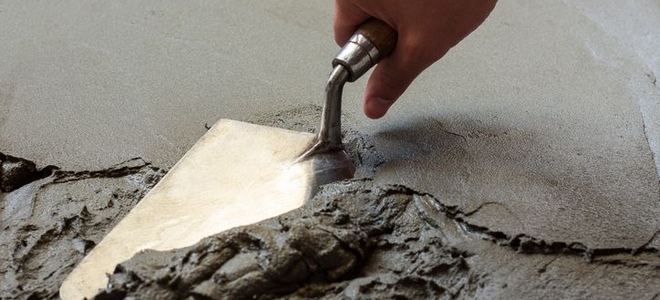

Step 4 - Finish the Concrete
The first step in the finishing process is screeding. A screed board worked front to back in a side-to-side motion will result in a roughly level surface. Next, you can use a wooden or metal float to get smoother finish. Finally, use a broom or wire-brush to get a grooved or textured surface.
