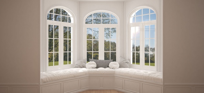

What is a better way to save space and provide function than in converting your window seat to a full-size pullout bed? If you are tired of letting your overnight guests sleep on a couch, or if you are limited to the amount of room you have and do not have enough sleeping space, try to find a box window, a bay window or any large window and create a window seat setting that will also act as a pullout bed when needed. Here is a fun how-to project for a rainy weekend.

Open the bed section. The back of the window seat becomes the platform, resting on the floor. The three folded sections become the layout for the bed frame. Add your mattress and fold up the bed. The mattress will become the cushion for the window seat
