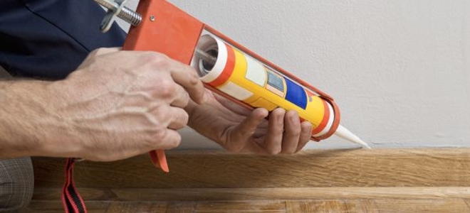

The first thing to keep in mind is, as the adage goes, “less is more.” Remember this especially when you're cutting the nozzle on your tube of caulk. With a sharp utility knife, slice off the tip of the nozzle at an angle (not straight across). This aids in ease and economy of application. I find that cutting a hole about 1/8 of an inch big produces a good bead for most small to medium-sized applications. Only tackle a couple of feet at a time, and apply just enough to cover the gap you are trying to fill. Remember that your bead doesn’t have to look perfect at this stage, but your cleanup will be a lot easier if you can avoid using too much.
“Tooling” for a Professional Look
Now is your chance to achieve caulking perfection. The tooling stage is all about removing excess caulk and shaping it to match the contours of the moulding or surface you are working with. You have the option of using a purpose-built caulking tool, but I find that a wet finger works just fine. Either way, you’ll also want a damp rag on hand where you can put the excess caulk that you remove. Keeping an eye out for potential splinters, carefully drag your finger down your bead of caulk, simultaneously forcing it into the gap and removing the excess. Use your dampened rag to clean any residue from the moulding and the adjacent surface. If you are filling a joint in moulding that has any sort of detailed profile to it, you will notice that it is difficult to get into those details with your fingers. A painter’s 5-in-1 is a great, versatile tool for working caulk into tough spots, but if you don’t have one of these on hand you might have to get creative. In this regard I’ve called upon everything from toothpicks and finish nails to credit cards and kitchen utensils, and they’ve all worked just fine.
