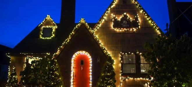

One of many people's favorite wintertime activities is in both installing outdoor lights at Christmas, or viewing other installations in the neighborhood. The process can be simple, with white icicle lights hanging from the eaves to a full blown display, with lawn and tree decorations.
Installing outdoor lights requires some thought and considerations. Although outdoor lights can be beautiful at night when all lit up, they can also be very hazardous if proper steps are not taken on installation. We list major considerations and precautions here.
