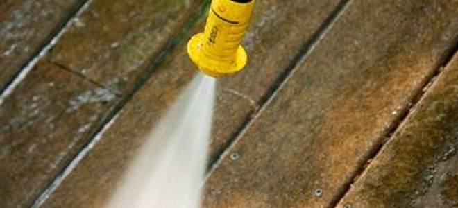

• Begin by removing any large debris by hand and place it in the trash bag.
• Sweep the debris on the deck into piles. Seep up the piles and place them into the trash bag.
• Remove any debris that is trapped in between the deck boards using the slender tool. Place the debris in the trash bag.
• Use the garden hose with a spraying attachment to spray the surface of the deck and rinse it clean. Use the highest or most powerful setting on the sprayer and direct it directly onto muddied or heavily soiled spots to remove as much of the dirt as possible. Begin at one end of the deck and continue until you have rinsed the entire thing. If you use a pressure washer to rinse the deck, leave a few feet in between the spray nozzle and the deck. If you hold the nozzle too closely to the deck, you will gouge the wood. Additionally, you should use the sprayer fan.
• Use the garden hose to spray in between the decking boards to clean away any remaining debris.
• Prepare a solution of sudsy water using the laundry detergent or read the instructions on the commercial cleaner.
• Apply whatever you are using for a cleaner to the deck. Use a long handled brush with stiff bristles or a push broom to scrub the deck. Begin at one end of the deck and work your way to the entire deck.
• Rinse the entire deck with the garden hose to remove the cleaning solution.
• For difficult areas to clean, you will need to take further steps. Areas that have some algae or mildew growth will need to be treated with a solution of one part bleach to four parts water. Be careful not to spill the bleach onto your clothing or any plants since it is harmful. Use plastic or garden gloves to protect your hands if you have delicate skin. The bleach solution may discolor the deck, so you can use an oxygen bleach cleaner to make the cleaning solution if you prefer. Pour the solution onto the area with the growth. If the growth appears fresh, then allow the solution to sit for only a moment or two.If on the other hand, the growth appears to have been there for a while, allow the bleach solution to sit for about fifteen minutes. Use the long handled brush with stiff bristles or the push broom to scrub the area. Rinse the area clean. Allow it to dry.
• If a stain remains on the deck after the first cleaning, then you will need to repeat the process. It is best to allow the area to dry completely before treating it again and to scrub the area for the fifteen minutes that the solution is on it.
• Thoroughly rinse the deck with the garden hose or pressure washer. Allow the deck to dry completely before sealing it. This may take as long as two or three full days.
