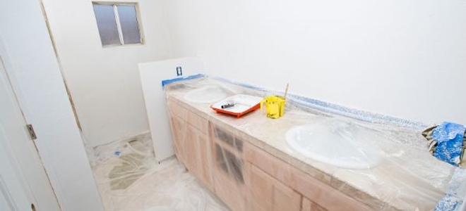

Refinishing Surfaces
Probably the most involved but effective way to change the appearance of unsightly bathroom wall cabinets is to completely refinish them. You can usually refinish cabinets over the course of a weekend of devoted and concentrated work. However, when you are finished, you will be happy with the new appearance of your cabinets.
Wood Cabinets: Refinishing wood bathroom cabinets involves removing all of the old paint and varnish. Remove any doors and drawers and use a sander to remove all of the existing paint and varnish. Once you have removed all of this material, wipe the cabinet and door surfaces clean with a damp lint-free cloth. Then paint or spray a thin layer of sealer and let this dry. You can then either apply a new stain or paint the cabinets for an entirely new look.
