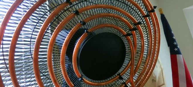

Step 4 – Attach the Coil
Remove the safety cover from the fan and place the copper coil on top of it. The copper coil comes already in the proper shape. You just need to bend one end so it extends out from the center just past the outer coil.
Starting from the center, secure the coil to the cover with zip ties. Use the flexibility of the coil to keep it even, so it spirals nicely out from the center to the edge. When you get to the end bend the outer end of the coil to where you want it and cut it if you need to. In my case, I wanted both ends on the same side of the fan, but you could put them on opposite sides, or bend them around so the attachments are hidden. Put the safety cover back on the fan.
