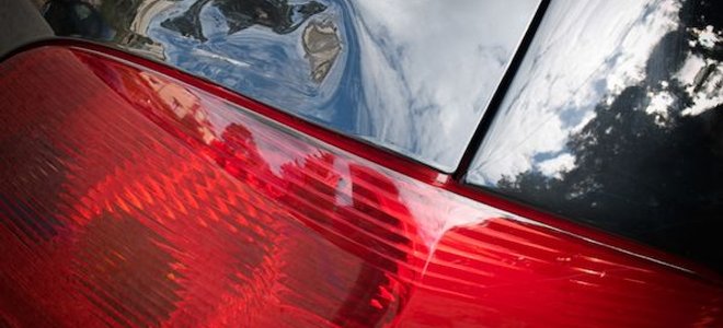

Paintless dent repair is commonly used to avoid more time consuming and expensive repairing methods. When you get a small ding in your car try repairing it yourself rather than hiring a professional auto repairer. Here are a few basic steps to follow.
Step 1: Examine the dent
First of all inspect the dent. Some dents may be fixed easily while others may require more extensive repairing.
