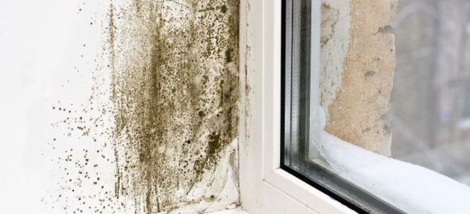

Step 1 - Locating the Mold
The most effective tool you possess to find mold is your nose. Pay close attention to the smells around you. Mold will smell like a damp basement. It will have a scent of mildew or be musty. A good indication of where mold will be is by looking at the drywall water damage. This is where the mold will begin to grow and then over time it will spread. There are areas of the home where drywall is more susceptible to mold. These places include the basement, attic, near appliances that use water, sinks, toilets and around windows.
