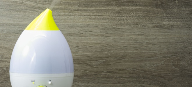

A cool mist humidifier, also known as a ultrasonic humidifier, doesn’t use a wick but instead uses a small metal diaphragm vibrating at ultrasonic frequency to break the water down into tiny water droplets. When they are blown by the fan, they become a fine vapor mist.
These humidifiers are incredibly quiet and use very little electricity. They also don’t require any replacement filters if you use distilled water in them. If distilled water is not used however, the device also produces a “white dust” made from the minerals in the water. The device is also prone to bacteria growth if not cleaned properly.
