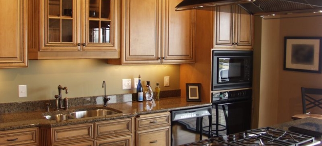

Granite can lend an exquisite look to any room. Tabletops, desks, kitchen islands, the list goes on and on as to where the look will fit in perfectly. But have you ever priced out real granite? It costs a fortune!
That’s where faux painting comes in. Faux painting can give the appearance of granite without the outlandish cost of it. It also happens to be one of the most enjoyable faux painting techniques. You’ll feel like a kid again as you splash paint all over the place!
The look of granite is achieved by sprinkling many tiny specs of different colored paints over a primary coat of a solid color. To get the most realistic look of granite, it’s best to keep your base coat black or a shade of gray.
