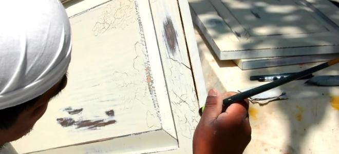

Pickling wood
If you're working on furniture or a cabinet, start by removing all the hardware. Depending on what you want the finished piece to look like, you'll have to decide whether to clean the hardware and reuse it for its old appearance or replace it with new.
If the wood has been sealed, you need to get the sealer off the surface since the pickling stain needs to get right into the wood grain. Use sandpaper or steel wool to remove the sealer and open the wood grain as well removing any dirt that might be on the surface. Finish the wood preparation by going over the surface with a tack cloth to remove any dust or residue from the sanding.
Start pickling by lightly dipping your brush into the pickling stain and brush it on following the direction of the wood grain. Wait a few minutes and wipe the stain with a dry cloth. Remember, you're not painting the wood, you're applying highlights so you want just some of the stain to remain down in the wood grain, but you don't want the wood to look painted white.
Keep up the process, applying the pickling stain and wiping it away with a dry cloth until you've "pickled" all the wood. It's important to use a dry cloth when wiping away the stain so you aren't putting stain back onto the wood.
Allow you newly "pickled" wood to dry thoroughly (probably overnight) then apply a clear varnish or polyurethane to protect the surface.
