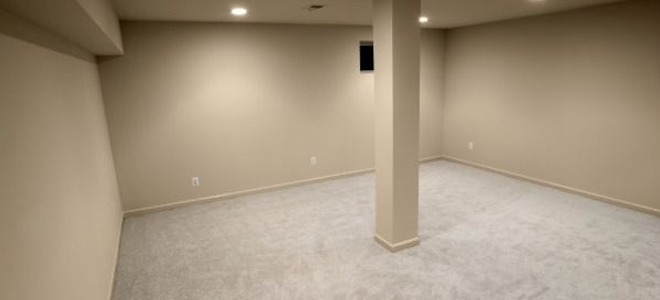

By finishing basement walls and applying insulation to them, you can convert an unfinished basement into a comfortable place for you and your family to spend their leisure time. If this is your first experience with this kind of construction, refer to the information below for instructions and a list of needed materials and tools.
