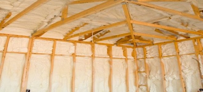

The metal furring strips need to be nailed to something solid in order to hold the ceiling and prevent it from sagging. The ceiling joists, the wooden framing members that hold up the existing ceiling, will work fine when the furring strips are nailed perpendicular across them. Use a nail everywhere a furring strip crosses a joist. If the ceiling joists are exposed, this is a simple procedure. If there is an existing ceiling, a little more work is required.
First you must locate the joists and mark them on the existing ceiling so that you will be able to nail the furring strips to them. If there is an attic above, you may want to crawl up and determine the direction the ceiling joists run. Usually they run across the short dimension of the room. Using a hammer, and tapping on the ceiling, you should be able to determine where the sound is more solid. Drill a hole or drive in a nail to be sure you have located a joist You can also use stud finders. Some new ones on the market actually measure the density behind the finish materials to locate studs and joists. Locate either end of each joist where they rest on the wall and then use your chalkline to pop a line down the center of each joist Once you have located the first joist all the others should be located 12", 16", or 24" from each other. It is still best to test with a nail or by drilling, since, in many older homes, and some newer ones, these distances are not always dependably the same.
