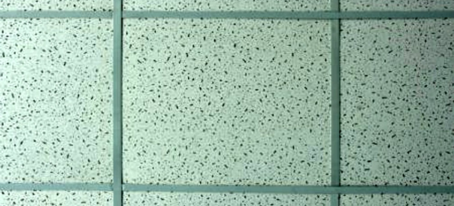

Design
Ceilings needn't just look nice; they can also do things: muffle noise, support lights, retard flames. An acoustical ceiling with tiny noise-trapping holes or fissures in the design is a vase choice for noisy rooms like kitchens and entertainment centers.
For rooms where fires are a possible concern, you can get ceilings made of mineral fiber, which is noncombustible. If you want to put lights in your new ceiling and relocate them without a lot of trouble, a suspended ceiling may be your best bet you can buy fluorescent fixtures that easily fit into the grid system in place of a standard-size ceiling tile.
Suspended and tile ceilings have several advantages. The greatest of these is weight. The ceiling is the only area of the room where gravity is working against you. Installing and securing heavy ceiling materials (such as drywall) can be difficult. The acoustical ceiling uses space-age technology to create a ceiling that is both lightweight and durable. It is easy to install and secure because of its weight. Also, many types absorb sound and thereby add to the sound control of the room. It comes in many different styles, sizes, and colors and is easily obtainable from any home center or hardware store. You can get tiles or larger panels that look like marble, oak, and other natural materials, with the designs authentically hued, shaded, veined, and striated. If you prefer traditional white, pattern choices have broadened to include reproduction of bleached wood, sculptured plaster, and rough-troweled stucco.
