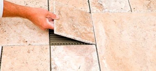

LAY THE FLOOR TILES
Start laying the tile at your markings in the center of the floor. It is important that the first tile is exactly square with the lines. If the first tile is started wrong, all other tiles will also line up incorrectly.
Be sure each tile is butted firmly against the previous one, leaving no gaps.
Do not attempt to slide tiles into place. Lay each tile firmly into position on the cement.
Proceed by laying tiles alternately, according to your plan, toward each wall as illustrated. This helps to counteract expansion and contraction of the tiles while enhancing the appearance.
