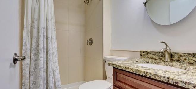

Just bought a $250 granite vanity top
Join Date: Jul 2016
Posts: 821
Received 0 Upvotes
Just bought a granite vanity top a big box store and read that two people had the silicone caulking that they used to fasten it down come through to the top and stain it. Have you ever heard of this happening?
What should I use when I affix it down to the vanity?
I'm also assuming that the old top which is formica sheet and pressed wood would just be glued down to the vanity.
How should I go about getting the old top off? Prybar?
Old Top
The old top is probably screwed from the inside. Look underneath near the corners for crews.

Another problem now. I measured my vanity and it's 22 inches wide and my countertop (the current old one on there) is 23inches. The new granite says fits 48 by 21 inch vanities.
I think you are saying the vanity is 22" deep and the new counter is probably about 21-3/4 to 22"??? (21 deep plus front overhang).
The new top probably won't work, you won't have an overhang at the front. You could take the cabinet apart and cut the depth back.

Is all hope lost ..... Maybe just put new Formica and take off the old sheet, new sink, etc??!
A standard vanity depth is 21", your new top was designed for a 21" deep vanity plus the front overhang.
The only way I know to fix this is to cut back the cabinet or purchase a custom top.
I haven't searched for pre-fab tops 23" deep, they might be out there.
It's not too hard to take the cabinet apart and rebuild it after cutting the sides and bottom.
If you don't want to take the cabinet apart you can remove it and cut the back sides and bottom.
By cutting the back, you don't need to disassemble the entire cabinet, only the back panel and the nailing rail.

Ok guys I think I know what I'm going to do. Laying new Formica looks like a pain, plus it would be cheap looking I think. I can't really afford a new vanity.
Someone suggested that I cut an inch off the width of the vanity and I was looking at it tonight and it looks like something that I can do.
What kind of saw could I use? Could I use some type of hand saw and then sand it down and put it back together, paint, etc?
Looks like what I have to do when I do it will be to take the top off and then the front and then the piece against the right on the wall and cut an inch off both sides and the bottom and then put it all back together. I think I can do it!
I'll cut it to 21 inches deep and then I can install one of my favorite counter sink combos. What do you think?

To cut down the width of the cabinet you need to uninstall it first. You want to remove the excess from the back. If your cut isn't perfect either caulking to the wall or small trim will hide the discrepancy. Depending on how/where the sink is plumbed, installing drawers in place of one of the doors might be doable. The main thing is having drawer fronts that match or compliment the doors.
I'd use a skil saw to cut it down, maybe a saber saw if needed. I only use handsaws as last resort
#29
Cutting granite is a skill that must be practiced to get good results. I suggest you do not attempt. Have it done professionally. Besides the cut edge will need to be polished. I had to have this done when my refrigerator would not fit the cubby hole provided. The counter top had to be removed, cut, polished and re-fitted. Although I did the full demo and remodel of the kitchen, I could not and would not attempt the counter top install or re-cut. Just say'n.

It is easier to remove the back. Shortening the front requires more precise cuts in order for it to go back together nicely. An uneven cut is less likely to show at the back. Narrowing up the cabinet is not something you can do with it still installed.

The front of the vanity has a bottom that goes all the way to the floor and then comes outward to the edge. In other words the vanity front recesses at the bottom so many inches and then continues to the floor as some vanities do.
I would assume with some patience and a good small blade handsaw and then some sanding that I could cut the inch off of the front on both sides and the bottom. I even would assume that I could make the cut by just taking off the old countertop. Of course the right side I would have to remove from the wall in order to cut.
By the way, what do you think is holding the vanity together? Is it most likely glue or small nails?
#35
Since the cabinet will be painted, I think you can cut the front.
Remove the top and use a hammer to carefully tap the face frame off. It should only have finish nails and a little glue. Get the frame off in one piece. It could also be remade easily.
The cleanest cut on the left side would be a router with an edge guide. You could get by with a jig saw and a multi-tool.
To hide any cuts on the left side you could add a 1/4" or 1/8" panel. The face frame would be shifted to the left 1/2" to hide the front edge of the panel.
