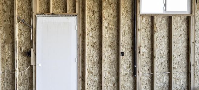

I'm in the process of replacing the rotted sill plate in my garage and some of the studs holding up the header are completely rotted through (my low-sloped roof leaked for years before I recently repaired it).
The outside of the garage is tile nailed to the plywood. While I've got the header jacked up to the replace the sill, I'm wondering what my best option for replacing the studs are?
Honestly, I don't care about the tile, so I'm thinking of sawzall-ing the nails between the rotted studs and the plywood and removing the entire stud and replacing it. If the nails holding the tiles rattle loose so be it...I could then toenail or use some angle brackets to resecure the plywood to the stud from the inside.
Would that work well? Or should I just add new studs next to the original and toenail them into the header and sill plate?
Like I said, the roof leaked so a couple of them are completely rotted/carpenter-ant-eaten (90% sure they're not termites), so they're bad from top to bottom. The rest are just rotted the bottom foot or two where moisture seeped up from the sill.
Edit: Was also planning on using a green 2x6 anchored to the concrete floor, as the sill and also a nailer for the eventual insulated 2x4 sleeper floor. Then, adding a second (possibly green) 2x4 on top of it as the base for the studs. I read double sills aren't usual for the floor. Is this overkill? Currently the studs are attached to the rotted sill on the concrete and there are cut 2x4s between them as nailer for the Sheetrock. I figured while not typical, the "second-sill" could be used as the Sheetrock nailer instead.
