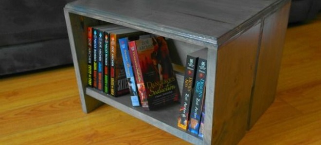

We have a friend on the move. Because of circumstances out of her control, she’s had to bounce from brief sublet to brief sublet, meanwhile most of her furniture remaining in storage. Because her most recent place was more than minimalist, we loaned her a high-back sitting chair so she had somewhere to relax. The only problem with the chair, though, is that it really needs a footstool, and we didn’t have one to accompany it. So I decided to build one. Because our friend is a bibliophile, of course I had to integrate bookshelves into the design.

I picked a grey stain/poly as a nice modern neutral. It wasn’t quite as deep a color as I wanted, so I ended up doing about six coats (sanding between each). But I didn’t mind the extra work, because I knew this piece would be at foot level. Kicked, shoved and put to use under tired heels.
How to Build a Bookshelf Footstool, table saw, Nico Rosso
After it was completely dry, made a surprise delivery to our friend. She was more than pleased, and immediately took advantage of the new shelves with some paperbacks. Now I can rest easy, knowing she can rest easy with her feet up and a book in her hand.
