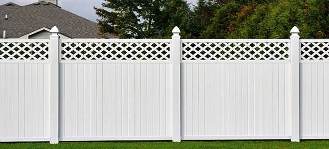

A privacy fence is both functional and decorative, screening out your private areas from prying eyes of your neighbors or people on the street while looking attractive. There are a number of options for privacy fences available in hardware stores that include pre-fabricated lattice or simple sheets. You can easily install a privacy fence yourself instead of hiring a professional.
Keep these steps in mind to build a 6-foot high privacy fence.
