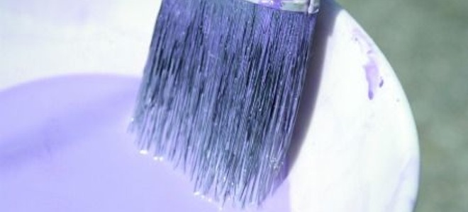

Step 2 - Clean the Equipment
Following the instructions on the can, use a small amount of paint thinner in a bucket, work the paint thinner through the brush and/or the roller. When the brush and roller is clean, shake off the excess paint thinner and wrap the brush in the waxpaper (or aluminum foil). Take the roller off roller frame and place it inside a plastic bag. The roller should not be stored on the roller frame, as the roller will often stick to the frame.
