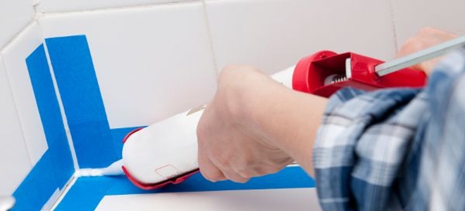

Step 1 – Fill Gaps with Caulk
After attaching the tub surround to the wall, look for any potential gaps. Point your caulking fun at the gap and apply a bead of caulk. Use the putty knife to push the caulk into the gap and smooth out the visible surface. Repeat for the rest of the gaps, and then wait for the caulk to dry before continuing on to the next step.

Step 5 – Caulk the Joint
Get your caulking gun ready to add the finishing touch. Apply a bead of caulk to the joint between the tub surround and the first layer of tiles. This is to make sure no water will enter from splashing. As above, use the putty knife to smooth out the visible surface. When the caulk dries, you’ve successfully finished covering the edges of your tub surround!
