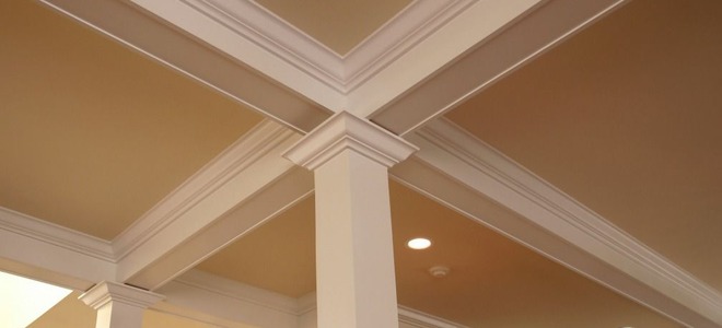

It is fairly simple to install crown molding for the outside corner of your wall without having to employ a professional which shall definitely prove to be expensive as well. Basically crown molding is solely used for decorative purposes, and it tends to bring in sophistication and elegance to the interiors of your house. Due to the fashion in which houses are constructed these days, it is not uncommon at all to find outside corners in the walls of rooms. Putting crown molding on such corners is a fairly simple task with the required tools and materials on hand. Follow the detailed directions below to cut crown molding for outside corners.
