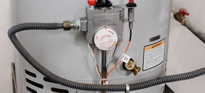

Most standard water heaters last between eight and 12 years. However, it should be noted that while an electric water heater can last up to 12 years, a gas water heater may only have a lifespan of six to eight years. The life expectancy of your water heater will really depend on a few different things including the location and design of the unit, how well it has been installed, your water quality, and the maintenance schedule. Also, because it's full of scalding hot water and steam, remember to follow proper safety precautions any time you are doing maintenance on your water heater.

After a while, your water heater will have built up sediment. This is especially true when you have hard water rather than soft water. If sediment is left to gather in the bottom of your water tank, it will cause a lot of damage! Not only do thick layers of sediment make the unit work harder to heat the water in the tank, but they can also corrode the tank walls, causing leaks. And as we know, once your water heater gets a leak in it, it must be replaced.
The solution? Flush the sediment out every year. To do this, you must turn off the gas or electricity. Then, attach a garden hose to the drain valve that is located at the bottom of the tank. Once it's connected, the sediment will come out through the hose, so make sure the end of your garden house is placed either in a floor drain, in a tub, or outside. To make sure you don't clog any drains, use a colander to catch the sediment. And remember—the water that comes out will be very hot! After you've emptied the tank, turn off the cold water supply to the tank and turn on a hot water faucet somewhere in your house. This will help drain the valve and the tank will then empty. Repeat this step a few times until the water heater tank is clean. You will know it's clean when the water turns from discolored and gunky to clear.
