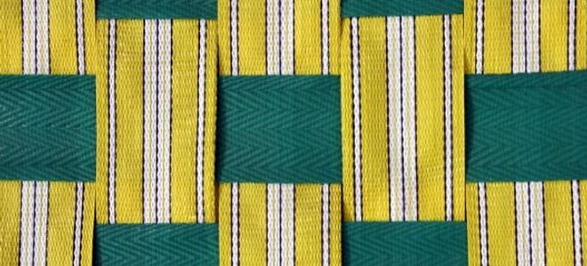

How to Glue Nylon Webbing
by DoItYourself Staff
Nylon webbing can be glued using a contact cement. A spray contact cement will bond the nylon webbing without the material coming loose once dry. The right glue will ensure the nylon webbing remains attached, especially if used for items that won't endure a lot of weight, such as nylon straps on a backpack or a lawn chair.
Prepare the Nylon Webbing
Cut the pieces of nylon webbing that you want to glue. Both sides that are to be glued should be dry and clean of dirt.
Spray the Nylon Webbing
Open the can of spray contact cement and spray a layer on the first nylon surface, with the side to be glued facing you. Spray another layer of glue onto the second surface where the nylon will attach. Place the first nylon surface directly onto the second surface.
For lawn furniture, hold both surfaces of the nylon together with a clothespin in place while they dry. Remove the clothespin after five minutes.
