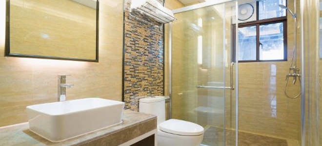

Installing a shower window is an economical way of providing natural lighting and natural ventilation inside a shower. Although some homeowners frown upon the idea of having a window in the shower, there are advantages to installing them. When remodeling a shower, it is a good idea to provide for a window that will allow the sunshine penetrate and allow air to circulate. One of the biggest problems in a shower is that the moisture can cause molds to grow anywhere. Installing a shower window is easy when there is a window frame already built inside the shower. When the shower does not have a window frame, then the homeowner should provide for one. Read on for more information.
