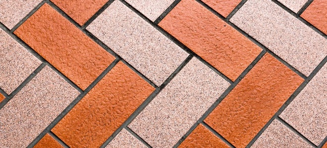

One of the hottest trends in ceramic tile is the use of brick tile in bathroom and kitchen remodels. This simple but classic look replicates the pattern and shape of exterior masonry brick. Among its many attributes is that you don’t need to be a master craftsman to install it. In fact, if you have even just a little bit of experience working with ceramic tile, you can tackle this job with fantastic results.
