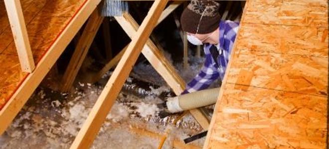

Step 3 – Lay Insulation
For rolls of insulating material, begin at the outer wall and lay the moisture barrier down against the floor surface. Tuck in the edges of the material against the joists and unfurl it along the space between them. Without stretching it, carefully pass the insulation beneath any power cables so that neither suffer damage. If the roll is longer than the space, use a pair of scissors to cut it before tucking all the edges against the joists. Continue in this manner throughout the attic and don’t forget to do the same with the top of the access hatch. Ensure that you leave a gap of at least three inches between the insulation and any lighting fixtures to eliminate fire risks.
If the joists in your attic are of a sufficient height and there is not a whole house fan in place, loose insulation can be appropriate. Pour the loose material over the attic floor so that it is as even as possible. Use a gloved hand to spread the material beneath cables and pipes. This will not be appropriate for the top of the access hatch, so attach a piece of blanket insulation instead.
Step 4 – Finish up
After completing the necessary work, you must ensure that the materials do not transfer to the rest of your house. Bag up any excess insulation before removing it from the attic and place your overalls in another bag. The overalls should be washed separately from the normal laundry.
