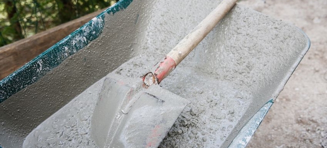

Step 2 – Dig Hole
Dig a hole using post hole diggers or shovel at the specified location of each pier. The minimum depth is 18 inches for any home but to ensure higher strength 36 inches depth is recommended. This depth can take the weight of the building better.
Step 3 – Place the Concrete Blocks
With the holes ready, place the square concrete blocks in the holes. Use square blocks rather than circular blocks, as they are stronger. For making crawling space, ensure that the concrete blocks are at least 18 to 24 inches above the ground level. This might require stacking the concrete blocks, if one length block is covered in the dug hole. There is no need to use extra concrete to stack them; the weight of the building structure keeps them firm.
Step 4 – Check for Vertical Level
Use the plumb line or vertical level instrument to check all the piers are in level. Check accurately for any error in leveling.
Step 5 – Fill the Hole
Using small stones and pebbles fill the spaces in the hole. It is essential as it blocks any large movement space in the hole, so that piers don’t go wayward under the weight of the building or during earthquake. Fill up the remaining spaces between the concrete block and small stones with the dirt and mud dug up.
Step 6 – Level with String Level
In the penultimate step to leveling, use the string level to ensure that the adjacent piers are leveled at the top. The string level is used at the top of the concrete blocks to check for leveling between them. Any error should be avoided and level the piers using the dirt to fill up the hole.
Step 7 – Tamper the Soil
After establishment and leveling of the piers, tamper the soil using a tamper or leveler, so that the piers foundation becomes firm. Tamping the soil settles the mud and dirt firmly in and around the pier. It pushes and presses the inner levels of the mud and stones to bind them together firmly.
