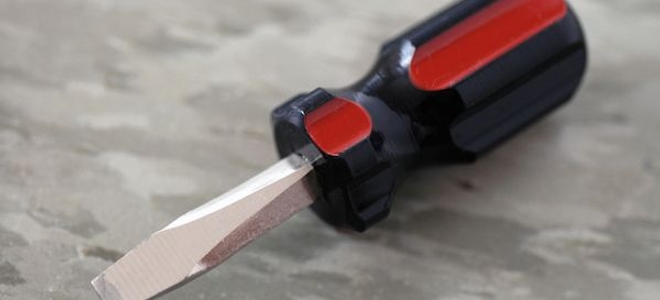

There are always going to be occasions when you might wish your screwdriver tip was magnetic. Reaching into a tight corners or screwing upward can be a nuisance if the screw won’t sit in the head of the screwdriver properly. Also there are constant issues with getting a screw out of a deep drilled hole where the tip will reach in but you can’t grab it to pull the screw out. There are quite a few methods by which you can magnetize your own screwdriver at home quite safely. One is a wired version which incorporates the use of a battery and the other is by use of a simple magnet.

Take the magnet in one hand and take the screw driver in the other hand. Start by placing the shaft end (near the handle) of the screw driver onto the magnet and run the length of the shaft along the magnet to the tip of the screw driver. Do this slowly but not extremely slowly. Come back and repeat the same motion four or five times.
Test again by touching the tip of the screw driver to the metal screw. If the metal screw responds by lifting up on the tip of the screwdriver you will have achieved a good level of magnetism. If there is a light lift but the screw doesn’t pick up on the tip, try running the screwdriver shaft along the strong magnet a few more times and then test again.
