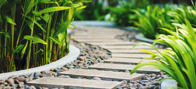

Cement pavers can enhance the overall look of a garden or backyard. These beautifully shaped pavers are available in the market in different shapes and sizes. However, the only problem is that they can be quite expensive. What most people do not know is that it is fairly simple to build your own cement pavers. All you need is some basic equipment and concrete, and you are all set to make unique cement pavers that will add to the beauty of your garden.
Molds for cement pavers are available in most large hardware stores. However, if you want, you can even make your own molds out of plywood. Whatever your choice, do ensure that you have lots of molds. Remember, one mold makes only one cement paver, and it will take at least two weeks before your cement paver is ready for use. Do keep the weather in mind when you’re getting ready to work on your cement paver. Freezing winters or cold rains are not the ideal weather conditions for undertaking this task.
