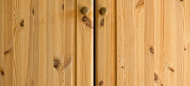

A cabinet door is an important part of your kitchen decor. With a few small changes to the cabinet door you can make big changes to the entire kitchen. One of the changes you can make is by adding some moulding around the edge of the door. By adding this moulding you are taking a flat door and creating a raised panel door.
