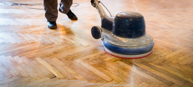

Some people may think that painting a parquet floor is sacrilege. But if your floors are in bad shape and don't have another sanding in them, or you just want a new and different look, painting parquet floors is an easier alternative to refinishing. This article will walk you step by step through the painting process to make sure that you have amazing results.
