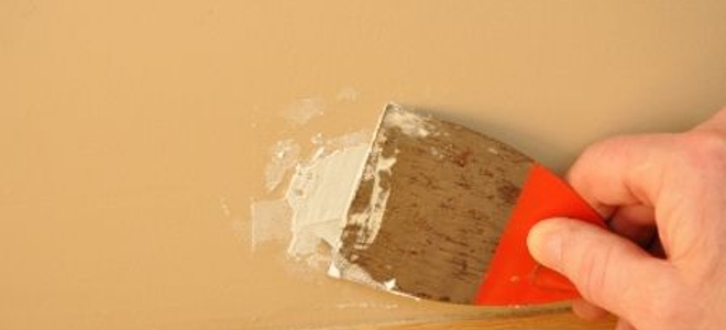

Step 5 – Apply the Spackling Compound
A putty knife in a container of spackle
With your spackling knife, scoop some compound and apply it on the hole or crack with a smooth, swift stroke at a slight angle. Start from the top and move down over the damaged spot. Press the spackle into the area with a little force, and then even out the edges to ensure that the application is uniform throughout. Let each coat dry, and then repeat application if needed. Make sure that a small amount of the compound is protruding outside. You can sand this part later.
Tip: Avoid the urge to keep smoothing out the patch and trying to make it look perfect. Remember, you are going to sand it when it is dry.
