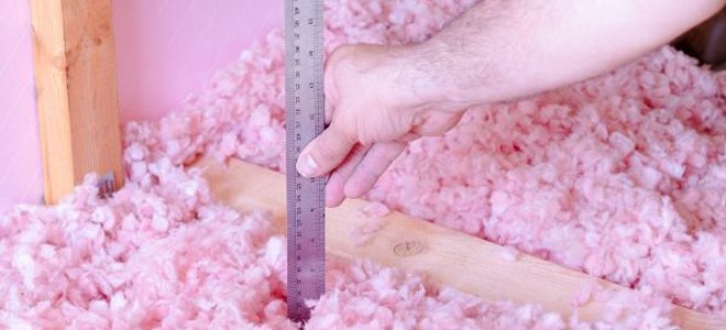

Whether you are removing loose fill attic insulation for replacement with new insulation, changing insulation types, or are removing insulation because of water or wildlife damage, doing it safely is the first step.
Prepping the Area
The first step in loose fill attic insulation removal is determining what type of insulation you’ll be working with. Use a test kit to determine if the insulation is comprised of asbestos. Older homes and buildings may have this type of insulation installed. It has a grey paper-like appearance and is extremely harmful to your health. If the test proves positive for asbestos, abort the project and call in a professional service to remove the insulation. Do not do this on your own.
It’s important to keep loose insulation in the attic during the removal process. You don’t want pieces of damaged, moldy, or mildewed insulation settling throughout the house. To prevent this, close all of the interior doors. For walkthrough areas, place a sheet of plastic over the opening and secure with tape.
To maneuver around the attic safely, lay large planks at least 6 inches wide across the joists. With these in place, you’ll be able to walk around the attic while removing the insulation.
