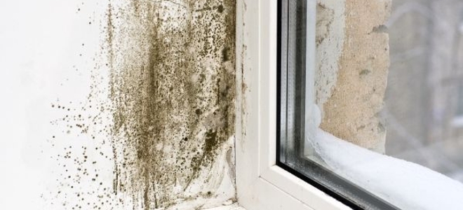

After the clean-up is complete from water damage in your home, you will most likely have some mold issues to deal with. It can take some time for the mold to become visible. You must remove the mold as soon as possible to stop its growth. With a few supplies and a little work, you can remove the mold without the help of a professional, so long as you treat it immediately.
