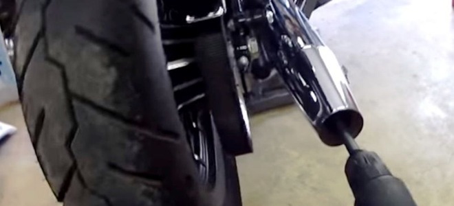

Step 2 – Drill Out the Baffle
With a ½” hole saw and a handheld drill, insert them into a hole in the exhaust’s outlet. The handheld drill will not go further inside the exhaust once you hit the baffle. Drill through the 1st baffle and then each remaining baffle until they are are drilled. Remove the baffle pieces.
